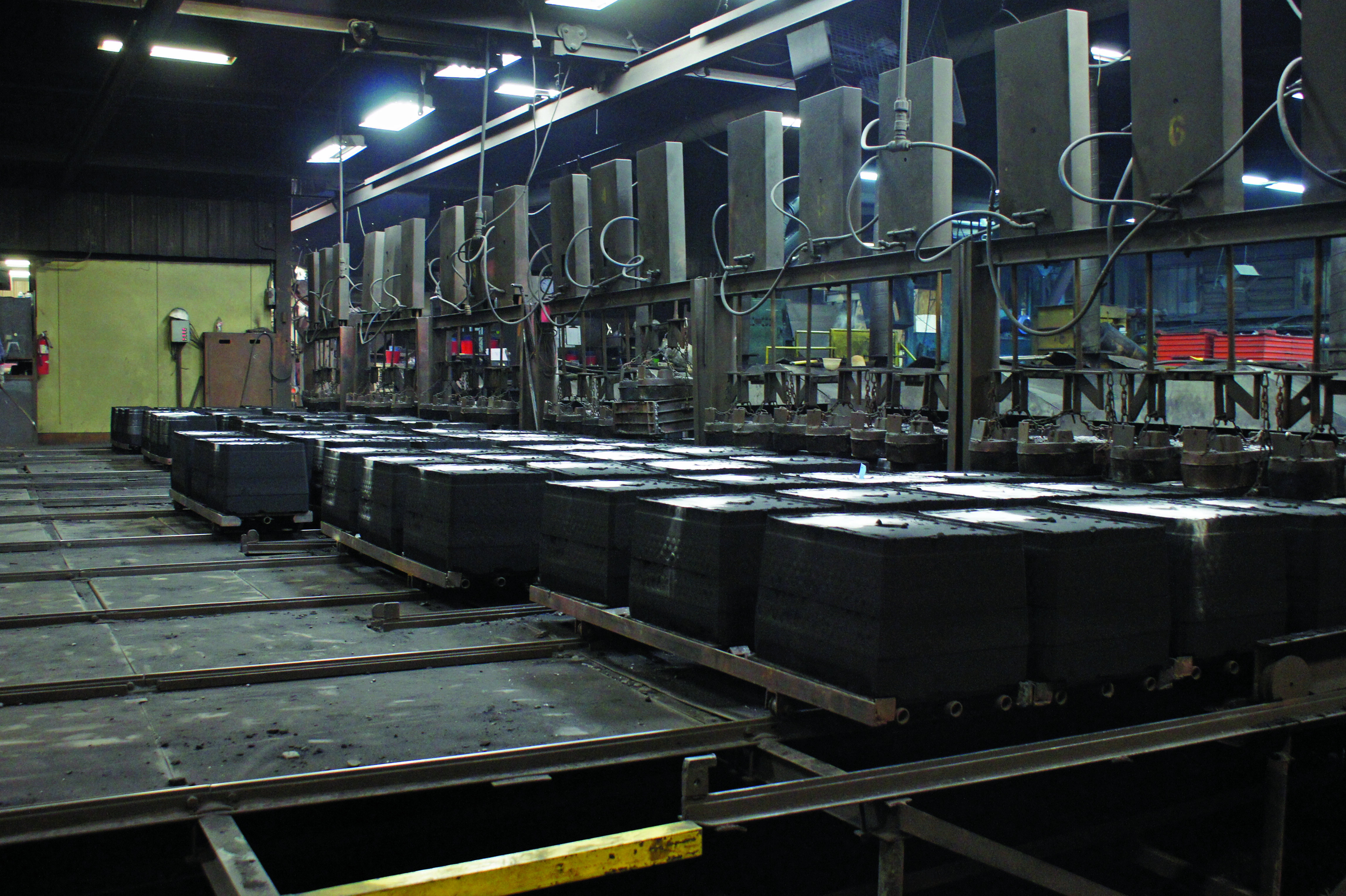

One of the areas in the foundry to receive additional staff included the maintenance team. Kolbeck made a significant investment from 2011 to 2014 to double core capacity and triple molding, melting and grinding capacities. A skilled and diligent maintenance department protects that investment and paves the way for future expansions.
“Our maintenance manager Guy Townsend started working here in 2016 and has been chipping away at tightening things up,” Soucie said. “We have made it pretty clear that we view our maintenance capability as a high priority, not only in keeping things running but also knowing when to buy new or when to buy used and rebuild.”
Hicks pointed out a recent example this past winter, when Ferroloy purchased a used sand muller. The maintenance team completely refurbished it, and with the help of two production people, tore out the old muller and put the new one in. The project was done below budget during Christmas break when the foundry was shut down.
“It’s just an example of what they can and are willing to do,” Hicks said.
The maintenance staff’s capabilities will be important as Ferroloy continues to improve its operations. It is currently in the process of adding 12,000-13,000 sq.ft. in order to expand the machine shop, add a pattern shop and remove foundry bottlenecks.
“The foundry is laid out logically: you start at one end and it goes all the way to the other end, but we are going to stretch it out and remove some old equipment,” Soucie said. “That will allow us to add another molding machine, double our melt capacity, add more core machines, add to our shakeout and blasting and move the grinding.”
The building will be expanded, but the larger investment in new equipment won’t be made until Ferroloy’s customers drive the need, Soucie said. When they do, the foundry will be able to meet the demand more effectively.

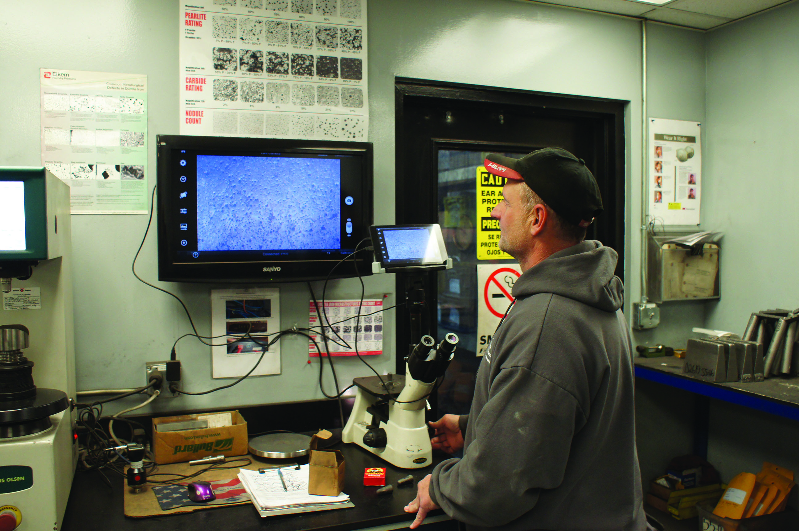

Ferroloy’s quality assurance program includes green sand control, Brinell hardness testing, tensile testing, chemical composition monitoring, and dimensional inspection.
