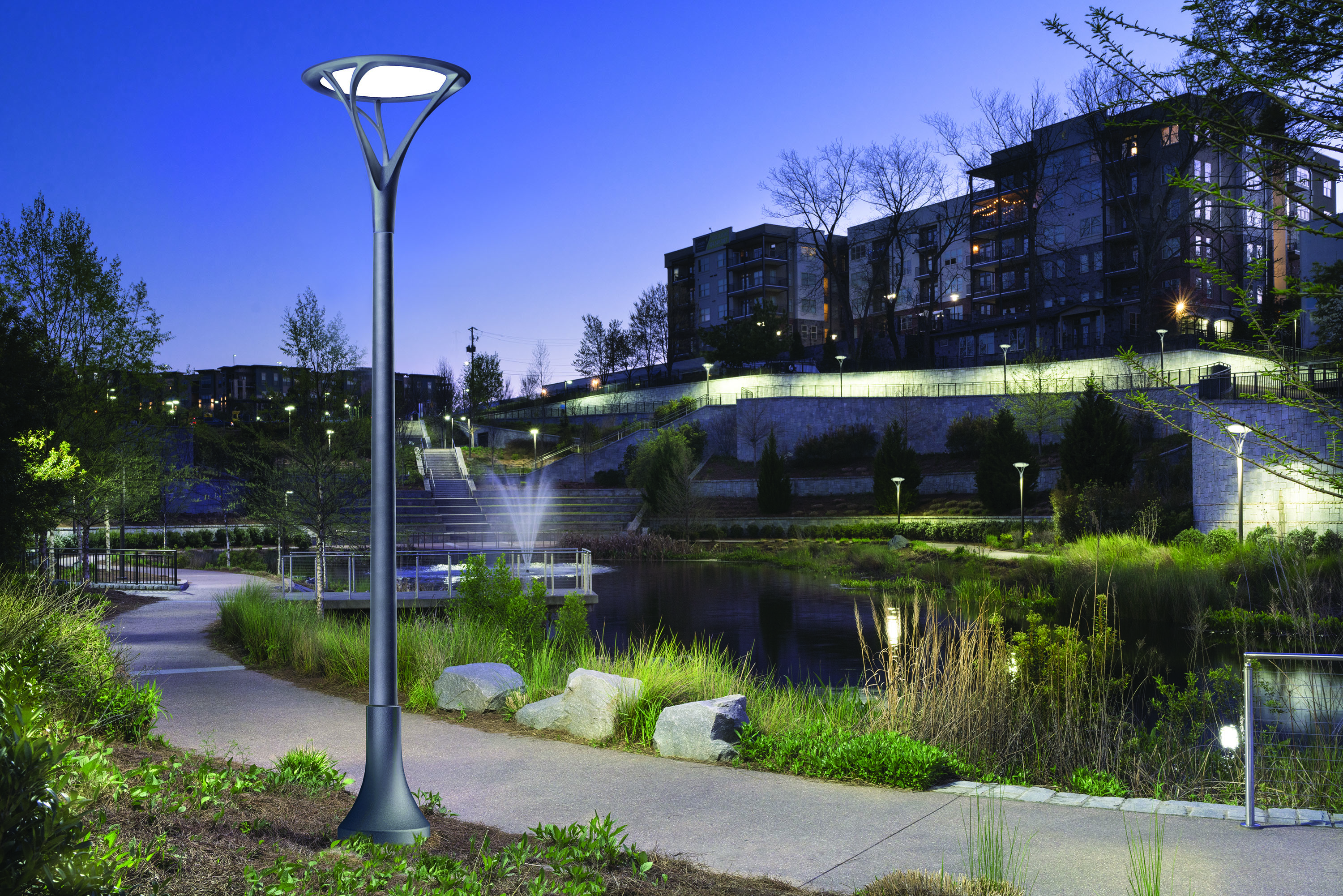

The cone-shaped fixture resembles a tree, and while its design stands out, it was not planned for manufacturability. The concept proved to be a challenging project for Powercast (St-Eustache, Quebec, Canada), but by working closely with the customer, they kept the design intact while adapting it to the permanent mold process.
Powercast general manager Ravi Gupta said it was determined early that metalcasting would be the best process for the project, since assembling or welding several castings together would not have been feasible.

The shape of the component was challenging. The part has thin sections, undercut areas, and various precise features necessary for post-casting machining and assembly of LED components. The pouring height, how to pre-heat the tool and warpage were among the issues Powercast had to overcome through experimentation and trial and error.
“Ultimately all these challenges were addressed by our team as a group effort, through many brainstorming meetings, disagreements and agreements, and challenging each other’s ideas,” Gupta said. “All of this led to a commonly agreed-upon consensus as per how to proceed. Every aspect of the process was discussed: how to design the tool, what materials to use, how the feeding/riser/ejector systems were going to function. How the operators were going to pour this casting, how it was going to be cut, grinded, finished and packaged.”
The customer provided various 3D-printed sections of the part and glued them together to create a life-sized model. After that, the customer requested sample castings in aluminum. Powercast produced plaster molding casting samples, which replicated the eventual appearance.
