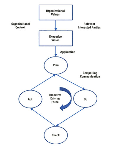

Executive action necessary to energize and maintain a safety management system can best be described in the diagram shown in Figure 1. This set of relationships derive from formal research and the management principles found in ISO 9000:2015. The result of the PDCA feedback loop in the diagram is a reduction in risk due to safety hazards, an increase in conformity to procedures and expected behaviors, and a reduction in the rate of occupational injuries.
figure 1
Figure 1. A diagram of the deployment of executive influence in the organization with respect to the safety management process.

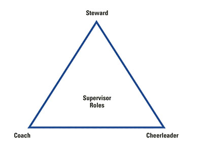

figure 2
Figure 2. The complementary roles of a direct-line supervisor in an organization are shown. These summarize and synthesize research related to best management practice, not specifically safety performance.

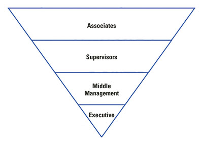

The executive’s role in the organization should be expressed as in Figure 3. In an organization committed to the primacy of human life, executives become servants, because their relationship to the human life around them is to nurture and protect it, even as they send the workers out to accomplish their production activities.
In Figure 3, the executive provides support through middle managers that report to him. The priority is to support these direct reports so they are enabled, equipped, and empowered to support the next layer.
figure 3
Figure 3. The inverted hierarchy shown illustrates the responsibility of the executive in values-driven support.
In such an organization, everyone serves a support role for the front-line associates, the people at the “top” of the organization. This inversion from the typical way a pyramidal hierarchy is displayed reflects an important recognition: The only ones in the company making anything that can be sold are the associates on the shop floor. Their needs are paramount to the organization, and protecting their safety and security is informed self-interest if nothing else. This suggests some strategies for executives to drive their values into the organization “top up” as it were.
