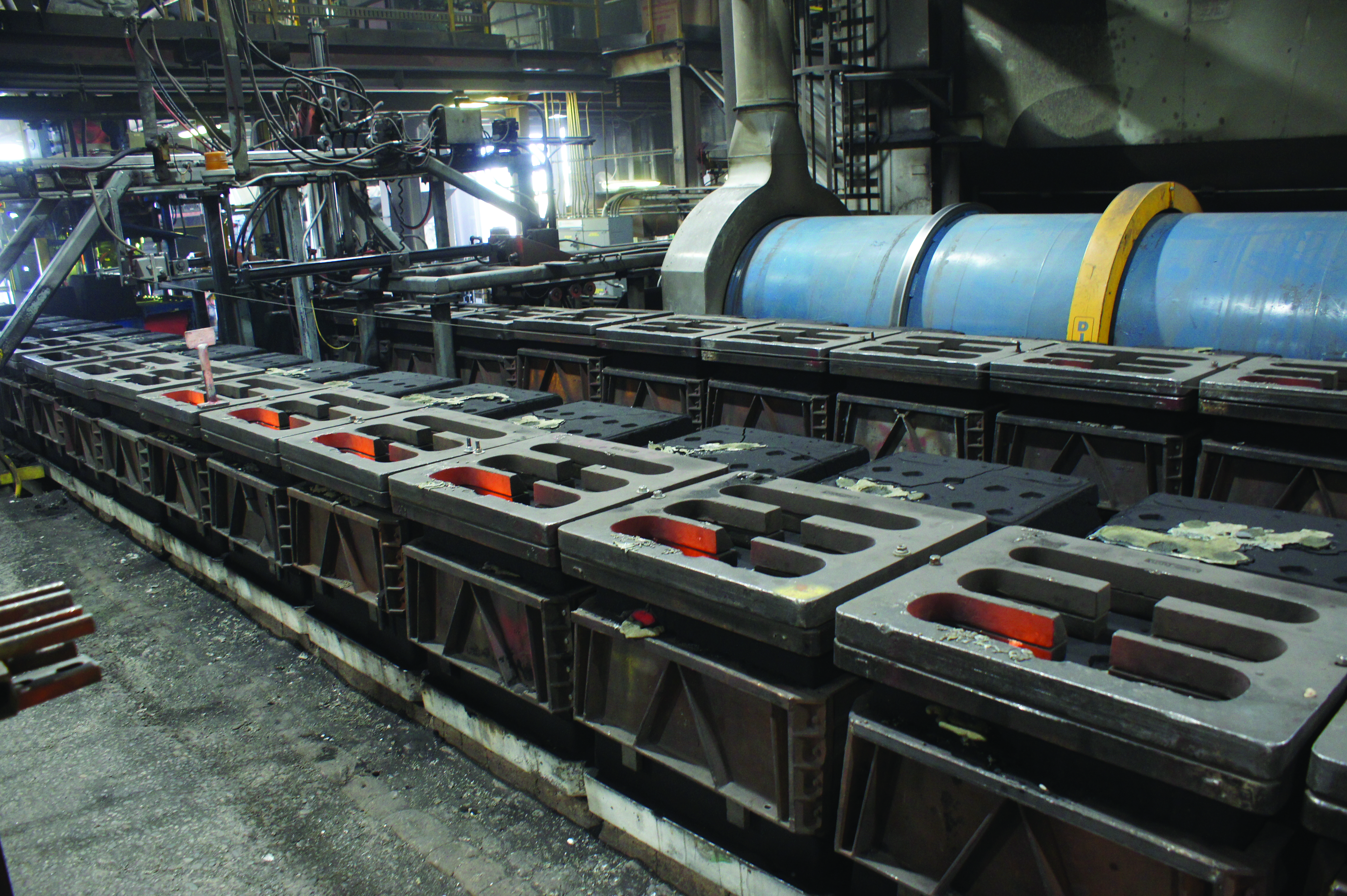

To prepare for the new molding material, Wear-Tek performed considerable small-batch testing beforehand. On weekends, between shifts, and during lunch breaks, the foundry would empty a small silo right before the mixer and run different recipe scenarios with the binder it had been using with the silica sand.
“We did a lot of research before and tried to get everyone’s opinion,” Summers said. “We made step mold patterns and poured castings out of that—not just with the Carbo product but many other sands out there to try to determine which media to use.”
Once it was time to make the full-scale switch, some fine-tuning was required to achieve the optimal molding parameters. Summers admits the results of the small-scale tests did not completely match up with what eventually worked best on the larger scale.
“We probably started a little too light on binder percentage, because we knew that is part of where the cost savings is,” he said. “But the molds were not setting hard enough at first. So, we slowly bumped up our binder, but it is still lower than what we were using for silica.”
This fall, Wear-Tek also installed mechanical reclamation for the nobake line to reclaim as much of the more expensive ceramic sand as possible. With the fine-tuning, the nobake transition went fairly smoothly. Making the change in the green sand line at Wear-Tek was more challenging.
To completely drain the sand system in the green sand line would have shut down Wear-Tek’s production for at least three weeks. Instead, the company opted for a more gradual transition. Early in 2019, it drained its green sand system to approximately 60% silica sand and then filled the rest with the ceramic sand. The ceramic sand is harder than silica, so over time, the silica sand broke down and was drawn off to the baghouse. As of October, Summers estimated the system to be down to 10% or less of silica sand.
