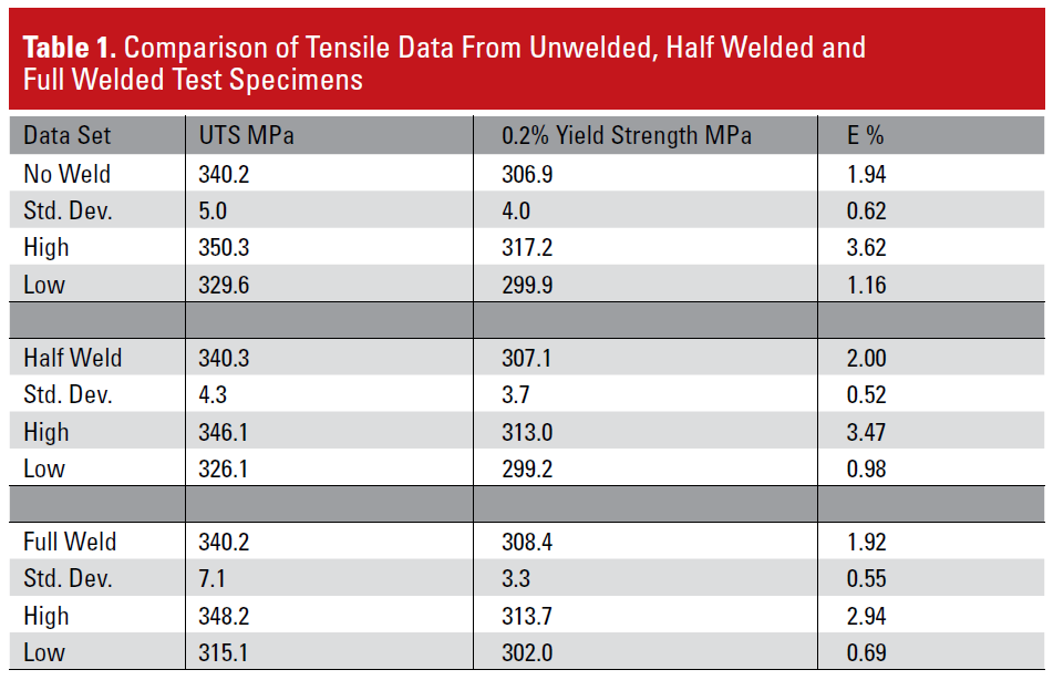

Recent work showed that properly accomplished in-process weld rework had essentially no effect on the static and dynamic tensile properties of E357-T6 sand castings. This work was done with sand cast plate, with a defect machined in to duplicate either a full weld or a half weld repair. Figure 1 illustrates that concept, and Table 1 shows the summary tensile data.
The fatigue data for the three types of specimens (Figure 2) are very similar to each other. However, regression suggest that the cast (no weld) specimens are slightly better (longer life) at high stress levels, the full weld and no weld specimens are about the same life at low stress levels, and the half weld samples demonstrated the longest fatigue life at low stress levels. This suggests either a difference in the microstructure, the geometry of any pores present, or the number of pores present in the original cast structure of the metal in the weld zone.
