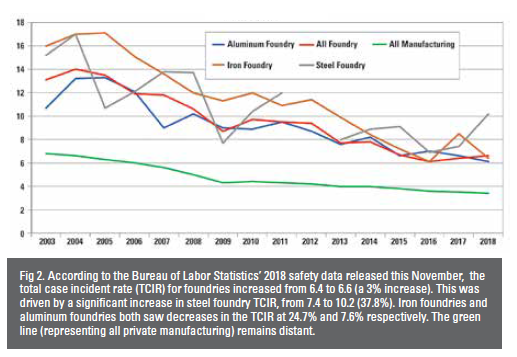

The standard data set from which safety statistics are drawn is available through the Bureau of Labor Statistics website, www.bls.gov. This data is reported as a rate of incidence using the standard formulas used by the Occupational Health and Safety Administration (OSHA). These formulas are well known to safety professionals and express the rate of recordable injury (the total case incident rate, or TCIR), injury resulting in lost time (the lost case incident rate, or LCIR), or injury resulting in lost or restricted time (the days away or restricted time rate, or the DART). These formulas standardize the count of injuries with a standard denominator that accounts for hours worked, normalizing the rates and permitting fair comparisons between large and small organizations.

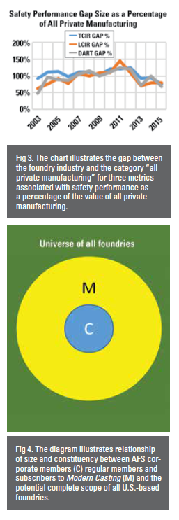

Based on available BLS data, charts can be prepared of the three standard metrics for both the foundry industry as a whole and the category of all private manufacturing. Figure 1 was developed from this data from the period 2003-2015. It plots the gap, or difference, between the safety performance metrics for the foundry industry and the same three metrics for all private manufacturing.
Clearly a gap exists in performance. This means the foundry industry numbers have been consistently higher than private manufacturing over this period. The TCIR gap has shown a downward trend (meaning the gap has narrowed between the foundry industry TCIR value and the TCIR value for all private manufacturing), but the DART gap has shown much less improvement, and it can be argued the LCIR gap has remained essentially constant over the period shown in Figure 1.
An important perspective on the gap between the foundry safety metrics and the all-private manufacturing safety metrics is that both are improving: the values of TCIR for example drop year by year for both foundry and all private manufacturing. The size of the gap as a percentage of the value given for all private manufacturing is considerably more constant, meaning while the gap is diminishing, the relative distance between foundry performance and all other manufacturing is stable. Foundry safety performance in all three metrics is about twice as high as all private manufacturing (Fig. 2).

To move the foundry industry safety performance faster than the trend of all private manufacturing to close the performance gap, special influence must be exerted on the industry. This requires a plan of action and the identification of those groups that can effectively influence the industry. The challenge is the number of those active in professional societies and industry associations in the foundry sector are a relatively small percentage of the total number of operating foundries. These active members are the least likely to contribute significantly to a higher injury or illness rate. The majority of foundries that experience safety performance problems are not directly impacted by the bulk of the activity and energy of professional societies like AFS. If significant change is to occur, it will require resources that extend the reach of the core membership and professionals employed by industry societies.
![Schorn 2](/sites/default/files/inline-images/schorn%202_0.png)
There are resources that can extend the reach and depth of penetration into that segment of the foundry industry not in direct contact with professional societies through membership. These include the following groups:
- Local chapters of AFS reach people who are not members.
- Foundry suppliers reach people who are not members.
- Executives reach people through personal friendships, civic association memberships and other professional interactions.
Members can reach people who are outside the reach of AFS through their emphasis on safety and safety methodologies through their other professional and civic contributions in other organizations where foundry industry people may be found.
