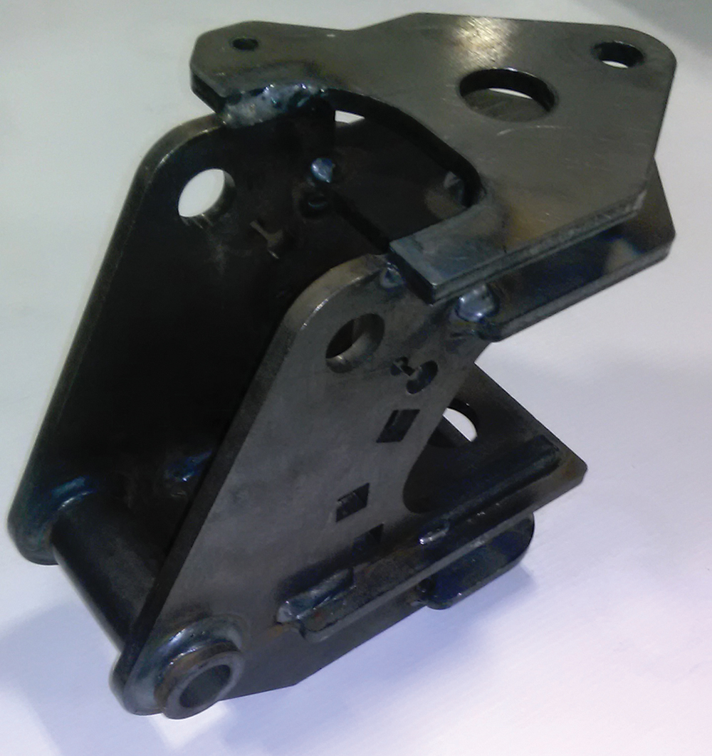

In April 2018, Amerequip and Neenah had several face-to face meetings regarding the project. Specifically, Amerequip had begun to evaluate the 11-piece laser-cut, welded-assembly part and determined it could benefit from a change in process.
Dorn and Amerequip saw where production volumes were trending for the component, and since they knew that other similar applications were being cast, it “just started to make sense” to pursue a conversion.
“We anticipated it was going to help us with production efficiencies and meeting our on-time delivery metrics,” Dorn said. “We’re getting in a finished product as a casting, as opposed to a multiple-piece weldment needing to be fabricated. All around, we felt we were going to see some nice advantages.”
Weld
The cast swing frame replaced an 11-piece weldment, pictured here.
Before those advantages were realized, work had to be done.
Both Neenah Foundry and Amerequip performed finite element analysis (FEA) to ensure the casting would meet strength requirements. This allowed Neenah to quickly see where it could eliminate material, which led to a weight reduction of 5.6 lbs., including machining. There was no hesitation in sharing models and screenshots during the design stage, which made the process go smoothly.

The part was designed to be manufactured with a single core, which helped to keep tooling and price-per-piece at a minimum. Assembly features, including holes and mating features, are now machined into the casting instead of the previous process of laser cutting and welding. The machined features can be held to tighter tolerances and provide a more accurate assembly.
“Looking at the weldment, there was a lot of excess material on the plates which was required for the purpose of welding the components together,” Slinger said. “Whereas with a casting, you’re able to simplify the design and eliminate the extra material.”

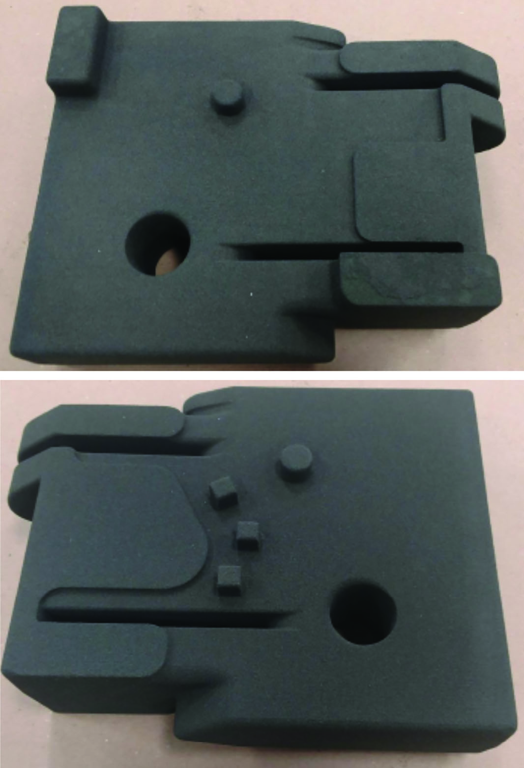

Slinger and the team at Neenah Foundry said it took “several iterations” and around 10 different tweaks before they completed the design. Once the final design was approved, Amerequip required fully machined prototype castings within a short time frame. In order to expedite the process, Neenah used 3D printed cores, which eliminated the cost and time associated with building a core box. It also allowed flexibility to change parts of the design after testing, if required. Neenah also was able to print gypsum-based 3D models of the casting itself, which were used to build the fixtures for machining.

To accommodate a short lead time on fully-machined prototypes, Neenah used 3D printed cores to eliminate the cost and time associated with building a core box.
