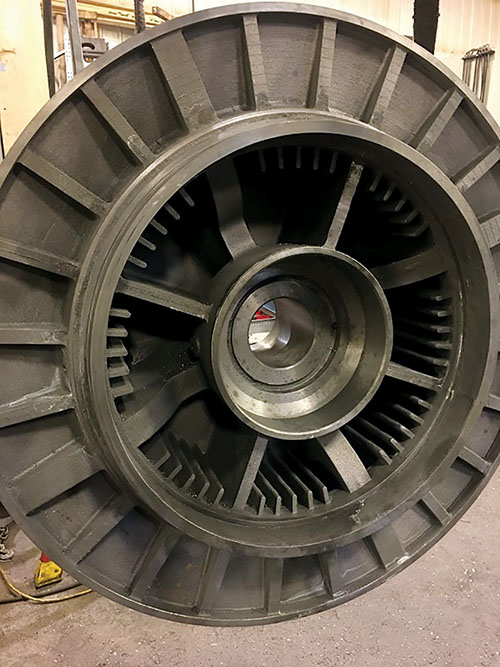

Late one wintery day in 2020, a huge 3D-printed sand mold––wrapped in mountains of memory foam––traveled by truck from Cedar Falls, Iowa, to Webster, South Dakota. Upon its arrival to a small, gray and ductile iron foundry, recipients at AFS Member Dakota Foundry felt a mix of elation and trepidation. Though it represented a bargain compared to the $100,000 cost of making tooling, the mold for a one-of-a-kind manufacturing replacement part was still a $30,000 investment. Dropping or bumping it was out of the question.
Printed and shipped in nine sections that the foundry assembled and glued together like a puzzle, the mold would shape the casting of a 2,000-lb. wire-stripper (wire drawing) block used in rare, old manufacturing machines at Parkway-Kew, North Brunswick, New Jersey. The company is primarily a metal coatings company that provides durability to high-wear components. Parkway-Kew’s owners, a father and son in their 90s and 70s, used a broker to locate a few U.S. foundries with the capability of casting a replica of the part that was last produced in the 1970s and for which no pattern existed. Dakota Foundry, as it happened, was the sole supplier that responded to their online inquiry back in July 2020.

Each wire stripper block sits on a large motor, Monson explained, and spins at high speed to stretch wire. It’s a process that generates a lot of heat, which is why cooling fins are incorporated into the design. The technology of 3D mold printing made it possible to cast the many fine details embedded in the old prints, which a part designer converted to CAD files for the customer. As a result, Dakota Foundry was able to cast the cooling fins as well as the wire feed grooves with exacting precision. Their work received recognition in this year’s AFS Casting Competition as “Newcomer of the Year.”
Specializing in low volume, high mix, as well as large and rare parts, such as those used in restored steam locomotives, the metalcaster partnered with the University of Northern Iowa (UNI) to produce the 3D-printed mold, which not only saved the customer money but at least two months in turnaround as well. Fitted with gating and risers and poured with 2,600 lbs. of molten, Class 35 iron, the finished single part weighed in at 2,000 lbs. and measured 48-in. in diameter, 17-in. in height.

Communication and collaboration between part designer and foundry is always mission critical to achieving castability, and even more so in the case of producing one very large, detailed, component. One theme of concern Dakota Foundry addressed with the customer and their CAD designer was the thin walls––under a quarter of an inch––for the cooling fins. It became a delicate game of give and take, widening as much as they could, but, said Monson, one adjustment in the simulation model had a ripple effect on other areas. Some tweaks would make the casting design too big and they’d have to creatively configure how to shrink the size back to required parameters.

But there were still some obstacles to overcome. One was the risk of burn-in because of the very fine grooves embedded in the casting design––pouring iron at temperatures between 2,500F and 2,600F, the foundry took preventive measures with abundant mold wash to protect against unintended marks being seared into the mold. Despite great care, the burn-in problem persisted and some had to be ground out post-casting.

Meticulous also describes the foundry’s approach while handling the 3D-printed sand mold, which was perhaps the job’s biggest challenge, at least in the minds of the metalcasters. Fear of breaking the expensive mold was an ever-present concern. Slow and steady was the mantra, said Plant Manager Juston Barse.
“This mold had all the fins and everything printed in it, so it’s not like you’re going to have three guys just grab it and set it in position,” Barse said. “You bust off the corners or snap off some of this 3D-printed material and we’re set back at least a month. And they’d have to print a new mold that we’d have to pay for. So we were just babying that thing, and everybody kind of held their breath the whole time.”

The team manually cut in all the gating and risers for the casting, he added, but together the group labored as much on the mental side as they did on the physical pour and finishing work. Pooling their deep knowledge and anticipating every way something could go wrong, the men strategized for a smooth feed and fill and were rewarded with a finished casting that satisfied every specification. Once the casting was poured, three guys worked a full day grinding by hand.
