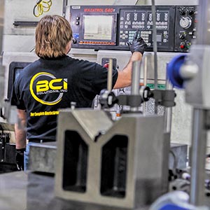

BCI Solutions has a “complete manufacturing solution” mentality toward value-add, and their in-house machine shop is just the beginning. Their offerings also include tooling, assembly, bar stock, bar codes, plus packaging and shipping. A collaborative, no-silo engineering team takes the service of design to a high plane of value for customers, too. During a June planning retreat, the company identified a new “Rock,” (aka opportunity/goal), Brown said, and over a 90-day period they’ll be investigating paint and coatings as a potential addition to their in-house value-add services.
