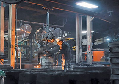

![pouring](/sites/default/files/inline-images/after3sept20.jpg)
Now, the foundry has been officially certified through the OSHA Safety & Health Achievement Recognition Program (SHARP), creating a safer environment for its workers and visitors and proving it has the program and culture to maintain standards—so much so that it is exempt from OSHA programmed inspections for up to two years.
